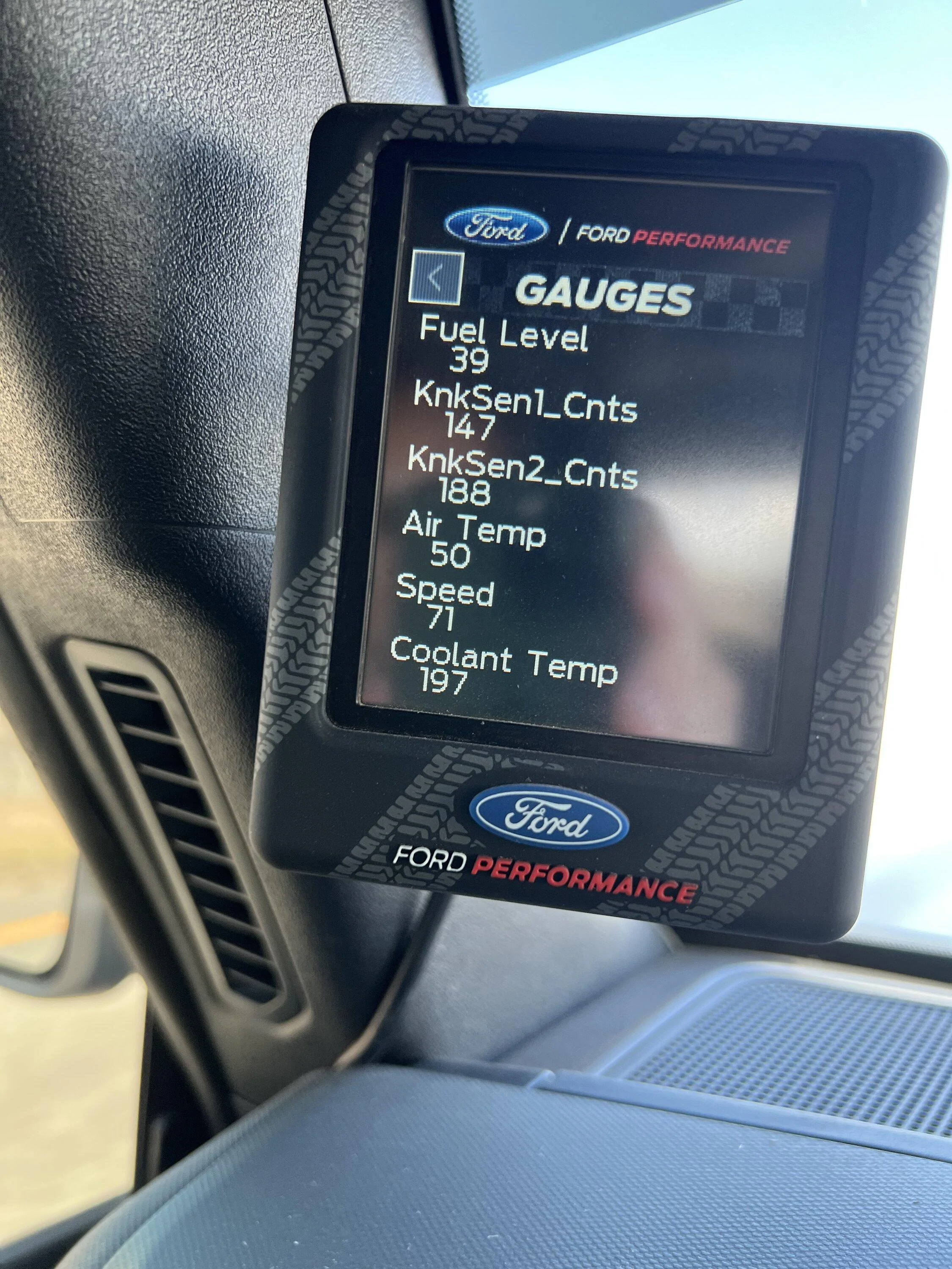

What are the normal values for Knk_Sen1_Cnts and Knk_Sen2_Cnts? What are the values that would indicate a problem? Also, what do the values indicate exactly?

the engine wasn’t cold, so this info is useless.

to see if you have a real problem, you'd want to watch (or datalog) the counts when under load to see if the count is incrreasing. That reading is a cumulative count from the current cycle, so those counts could have happened when the engine was cold.
The knock/pre-ignition that you should be worried about is when the engine is hot, as it can damage pistons due to the spontaneous nature of detonation. Knock readings from cold starts are more likely from additional tolerance in engine components when everything is cold.
If there was a real problem with knock/detonation you'd bee seeing counts in the thousands
