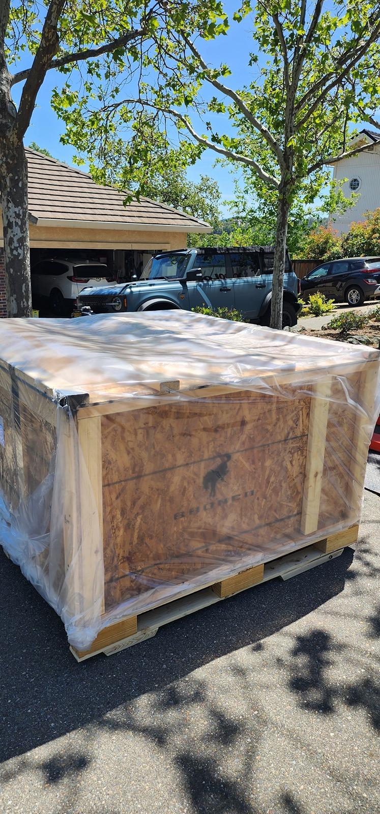

I would love to have that crate! I would cut the part out with the Bronco logo, frame it with the support planks and put it on the wall in my man cave, garage or some other such place.
I plan on making a ceiling mounted storage box for my top.

Received mine as well (last week). I'm going to take the crate apart, cut up and use for attic flooring. Whenever I get extra plywood that's what I typically do.
